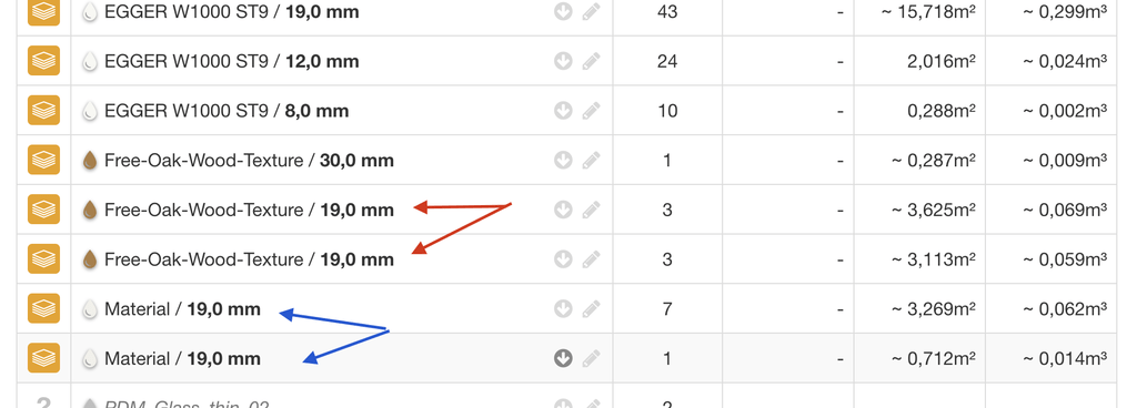

Hi, since the last update i've a problem with your cutlist.
there's a Project i have. I wanted to create a cutlist and here is the Problem.Despite i have parts with the same material (material is defined, same thickness but different width and length). But cutlist is dividing it in 2 parts (as you can see in the pic). so it makes it impossible to me to have 1 cuttingplan for 1 material. I don't have any idea what's going on. Do you have a clue?
Hi,
It's certainly the same problem that is described in this issue.
In your model, some parts doesn't really have the true thickness of 19 mm. But Sketchup rounded the dimensions.
Since few version OpenCutList uses the real size of parts, not the rounded one.
💡 Can you try to install the current 1.9.9-dev build where things are displayed differently when this problem occurred.
