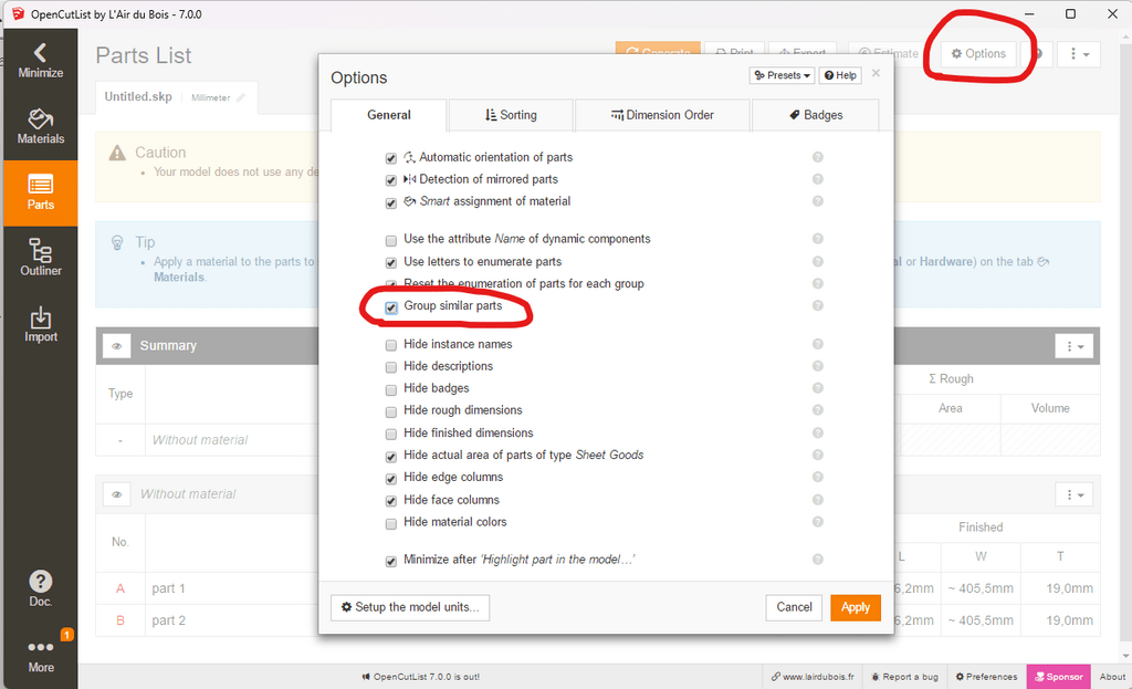

This is already possible. Navigate to the Display Tab of the selected Type of Cutting Diagram and select the option Group Similar Panels. This will group all panels having the same parts and cuts. Caveat: if you use instance properties in the Formula just above, grouping may be disabled.

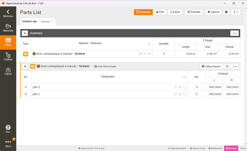

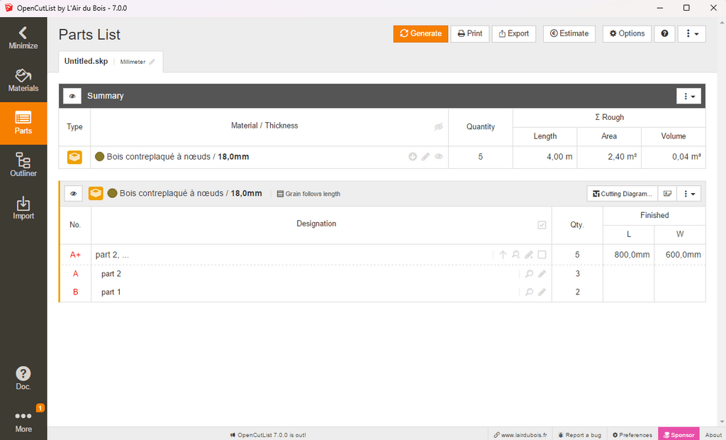

You have an option made for this purpose : "group simlar parts".
Note : you'll have to apply a "solid wood", "sheet goods" or "dimensional" material to the parts.

Can you provide us with screenshots of a simple example with the material properties and part list settings?
