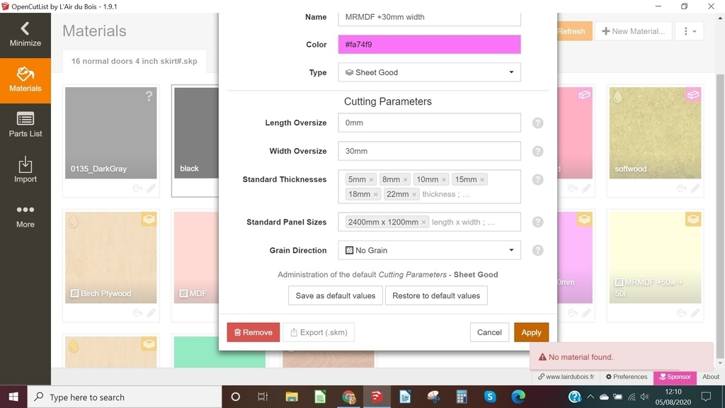

I'm new to opencutlist and love it, however on my first model I have a problem. I have made materials for MDF, but for some of them it says "No Thickness defined", but if I click the "add thickness" button, nothing happens.
Then if i edit the material and type in the thickness (in this case 12mm) it comes up with the message "No Material found"
can someone help ? Many thanks

Hi, i've attached a screenshot, what I am finding if i try and make mdoifications to some of the materials it says "no material found", i've tried various solutions but still there is the problem

Could you try to remove the « + » from material name ?
mightyg
It worked !! Thank you very much Boris - that is such a relief :-)

I read more of the forum questions and found one which was similar. I think the issue is caused by using another material as a template, and if it doesn't have the thicknesses defined then you cannot add them. I have since made fresh materials to do the same thing and it seems to work.
It would be good if the issue didn't exist, but at least there is a workaround :-)
